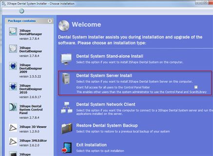

2. Make Dental System™ server installation on existing PC
Perform Dental System™ server installation on Existing PC (Leave your dongle in Existing PC).
3Shape Dental Syste server installation on existing PC

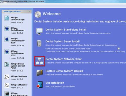

3. Make Dental System™ Client installation on New PC
Perform Dental System™ client installation on New PC.
3Shape DS client installation on New PC

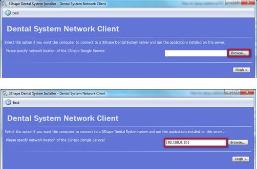

Select Existing PC as a server. Either browse for the Existing PC or enter the corresponding IP address manually.
network address
