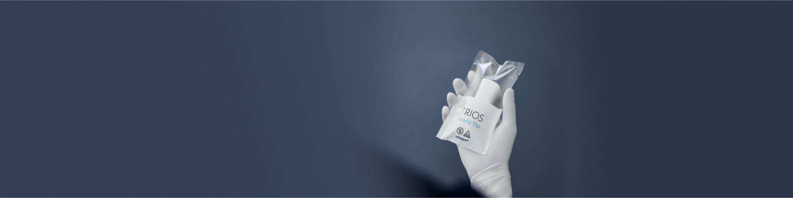

TRIOS Ready Tips
With a single-use TRIOS Ready Tip, it really is as simple as: open, place, and scan! These new tips are designed for dentists and clinic staff who value the convenience of always having a new tip on hand.

Always-ready
Discover convenience redefined with a tip that’s always ready to use, straight from the box. With TRIOS Ready Tips, your team can spend less time on cleaning, and more time on patient care.
Hygienic every time
Reach for a TRIOS Ready Tip and experience full confidence that it delivers the level of hygiene you and your patients rely on. Each Ready Tip is single-use and designed with an enclosed tip, minimizing the risk of patient cross-contamination.
