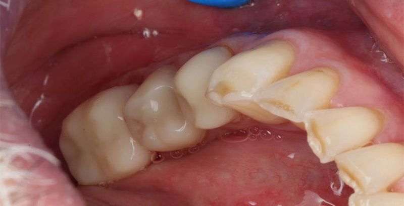

Dr. Austin Vetter: The quality of 3D-printed restorations has been truly impressive in terms of fit and finish. I've been particularly excited by the advancements in new ceramic-filled printable materials.
However, a year ago, I began using a certain FDA-approved material and observed noticeable wear in the restorations. It has meant that we have had to occasionally replace some of the crowns.
The material I had been using was not robust enough to endure the posterior forces related to wear.
I'm hopeful that upcoming materials will better resist wear and tear.
Yet despite this, 3D printing still serves a valuable role as a cost-effective placeholder for patients who require but may not be able to afford more definitive treatments. It has made my job easier to offer these options rather than crafting restorations by hand.
