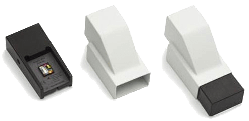

Youll also need a color calibration kit. The color calibration kit consists of a white piece - mounted on the TRIOS tip and a black box with a color pattern on one side and a grey square on the other side.
