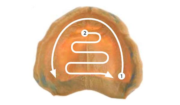

Scanning the maxilla impression
Proper strategy is required to achieve global accuracy in scanning the maxillary impression within the prosthesis due to its wide surface and anatomical features, including palate shape, undercuts, and ridge form. Fortunately, this can be handled easily.
Get the full path recommendation and step by guide on scanning the maxilla impression by downloading the full scan strategy.

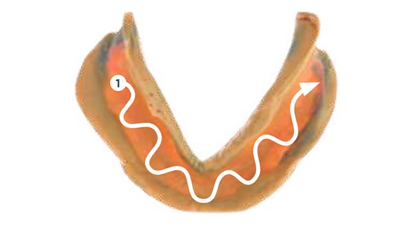

Scanning the mandible impression
The goal of scanning the mandibular impression within the prosthesis is to achieve global accuracy. This goal is achiev-able, but it requires a proper strategy due to the mandibular impression’s narrow surface and anatomical features, like the retromolar pad, alveolar ridge, lingual borders, and undercuts.
Get the full path recommendation and step by guide by downloading the full scan strategy.

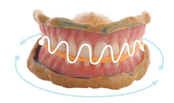

Scanning the occlusion
The goal in scanning the occlusion is to ensure adequate alignment of the maxillary and mandibular reference dentures in centric occlusion. This can effectively be accomplished by conducting the occlusion scan in two manners:
  1. Utilizing the bite scan feature
  2. Conducting a 360 bite scan alignment
Personally, I prefer the bite scan feature for its predictability, efficiency, and accuracy. The feature involves simply scanning the maxillary and mandibular reference dentures either intra- or extra-orally. I prefer to conduct this method by using a rigid bite registration material and capturing the patient’s repeatable unstrained centric relation record.
Get mr. Kuckuka’s tips on how to trim excessive registration material on the buccal aspect by downloading the full scan strategy.
