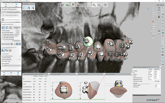

The major change is that your workflow is now setup based and our Bracket Placement workflow now automates the movement of teeth for you.
So professionals using the 3Shape Bracket Placement module, simply first choose the bracket library and wires they prefer. Then with just a click, the software automatically adjusts your patient’s malocclusion to create the ideal setup.
You can then make any small adjustments to the setup you prefer, which the software correspondingly changes in the bracket placements. Doctors with their own vision for ideal setups can save preferences to always create that setup.
So whether you are an orthodontist in Europe who prefers raised laterals, or you’re looking for a Hollywood smile, you choose your ideal setup for that patient and the software creates the bracket or even aligner treatment for you.
In essence, you are starting your workflow based on the ideal setup. The software creates it for you and you make any minor adjustments needed.
Using our 3Shape Bracket Transfer workflow, you or your lab partner can then create the transfer media to bond the physical brackets in the patient as well.

3Shape’s indirect bonding solution is an automated workflow with you in charge. If you adjust a tooth in the setup, the software automatically adjusts the corresponding bracket and wire setup. The adjustments you make to the teeth are made to the brackets before they are even placed in the patient.
Automation also enables the entire team to work together more efficiently. The doctor and the lab can divide the workflow as they see fit.
With our indirect bonding solution, it is possible to save your change and share the edit with your partners anywhere in the workflow. A doctor that is focusing on chair time can have assistants do the initial teeth movement because it is automated and then review the case and make any adjustments they see fit. If the doctor decides, upon receiving the prescription from a lab, to make some edits he/she can do it and send the edited file to the lab. It’s simple and it’s fast.
Lastly, when it comes to actually placing the brackets, that’s been made more efficient too. We have workflows that work with any manufacturing equipment. Regardless if it’s a printer, vacuum press, or you are working with bio or non-bio compatible materials, there is a workflow for it.
