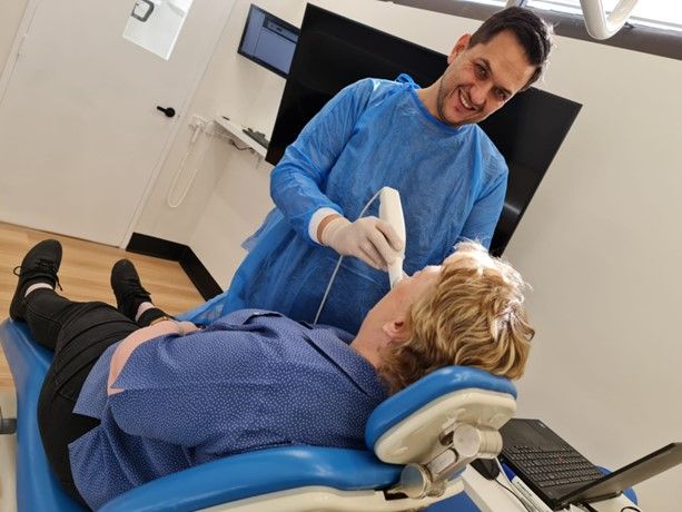

6. Frontward face!
Lastly, the case to frontward face! I was a little scarred when training dentists over the years to tell them to get out from the back seat and into the driver’s seat of the scanner process (so to speak).
Doctor scanning patients mouth
The case to forward face when intraoral scanning
To stand in front of your patient provides some very big advantages. Firstly, you are firmly grounded with full visibility of your screen as well as your patient. Front facing means full access to hand positions only possible in this posture. By standing in front of the patient you can also react to the oral environment quickly. You can take visual cues from your patient if something is uncomfortable, for example. The advantages in complex scanning are immense.
Why not see what analog protocols you can digitalize? There is very good chance it will be world first as we work together to provide the optimum experience for our patients.
Why is it still so uncommon to sit in front?
The reason is because dentists are so used to sitting behind a patient. So, it's easier to just keep that same posture as they are generally still sitting, and patient still reclined. When conducting training, I used to be scared to tell dentists to stand up. But I now realize that more than half of the issues they have are generally solved with this very simple tip (and some practice). We did a lot of filming to document this, and the films have confirmed the benefits of frontward scanning.
And so, I rest my case to Frontward Face!
