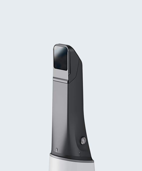

In clinical use, an intraoral scanner captures a digital impression by scanning the surfaces of the teeth directly inside the patient’s mouth and is increasingly considered essential equipment in modern dental practice.
Modern systems are designed to be ergonomically suited for intraoral use, including devices with a compact intraoral scanner design.
The device is moved across the dentition, collecting visual data that is continuously processed into a 3D representation.
As the scan progresses, the system builds the model in real time, allowing the clinician to see the captured areas and identify any missing data.
